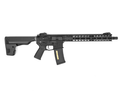

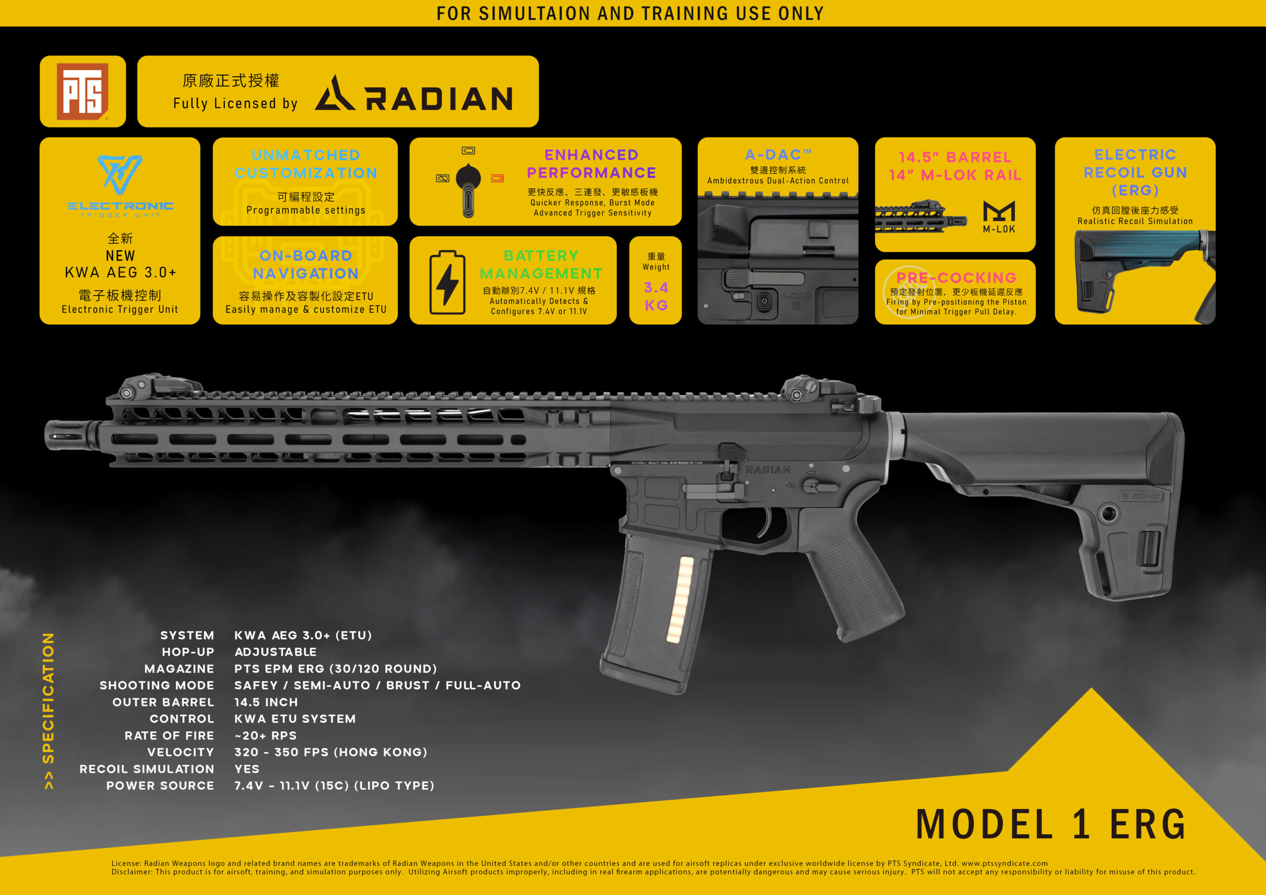

The Radian Model 1 (ETU) is a PTS-licensed 6mm AEG airsoft rifle with KWA’s AEG Recoil system and the KWA Electronic Trigger Unit (ETU) pre-installed. It shoots 370–400 FPS in semi, burst and full auto at 23 rounds per second, comes with one PTS EPM ERG 30/120-round magazine, and has a 14-inch M-LOK rail and a compact Enhanced Polymer Stock.

For the first time, the Radian Model 1 comes as an AEG Recoil rifle. It is built for fans of the Radian Model 1 who want KWA recoil and a programmable trigger in one package.
The KWA ETU puts control at your fingertips. Adjust trigger sensitivity or switch burst modes on the go, and the ETU detects and configures for 7.4v or 11.1v batteries automatically. Prefer gas? The Radian Model 1 also comes as a gas blowback rifle.
- KWA ETU pre-installed: precocking, burst, trigger sensitivity, equalizer
- Semi-lock function and brushless motor mode
- KWA AEG Recoil system
- Detects 7.4v and 11.1v batteries

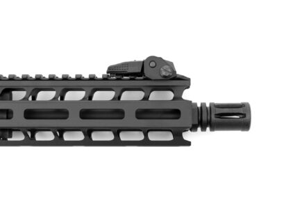

- 14-inch M-LOK rail

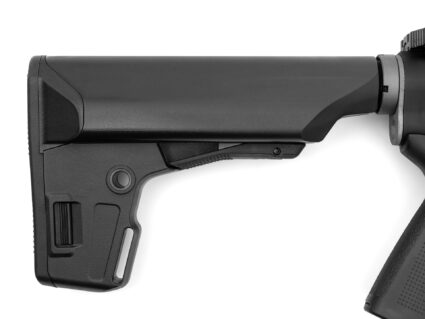

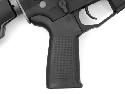

- PTS Enhanced Polymer Grip and compact Enhanced Polymer Stock
- Enlarged trigger guard and switch life extender
- Rotary hop-up and one-piece upper receiver

Radian Model 1 (ETU) Specifications
| Performance | |
| Power system | AEG Recoil |
| Trigger | KWA ETU, pre-installed |
| Velocity | 370–400 FPS |
| Rate of fire | 23 rounds per second |
| Firing modes | Safe, semi-auto, burst, full auto |
| Magazine | PTS EPM ERG, 30 or 120 rounds |
| Hop-up | Adjustable (rotary) |
| Battery | Li-Po or Li-ion, 7.4v or 11.1v (not included) |
| Dimensions | |
| Length | 32.5 in retracted, 35.25 in extended |
| Height | 10.5 in |
| Outer barrel | 14.25 in |
| Inner barrel | 11.75 in |
| Weight | 7.5 lb |
| Build | |
| Platform | Rifle |
| Rail | 14-inch M-LOK |
| Stock | PTS Enhanced Polymer Stock, compact |
| Grip | PTS Enhanced Polymer Grip |
| Muzzle | AR flash hider (orange mock suppressor installed) |
| Receiver | One-piece upper, enlarged trigger guard, switch life extender |
| Collection | PTS Licensed |
