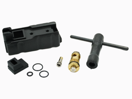

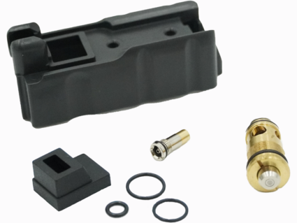

- Ensure feed lips are intact and free of cracks or deformation.
- Inspect the center of the fill valve for a small o-ring before filling.
- Depress and release the release valve and verify the button freely opens and closes.
- Apply a drop of silicone oil to the top surfaces of the magazine main seal just behind the feed lips, this promotes a proper seal between the magazine and BCG.
- Replace parts as necessary.
